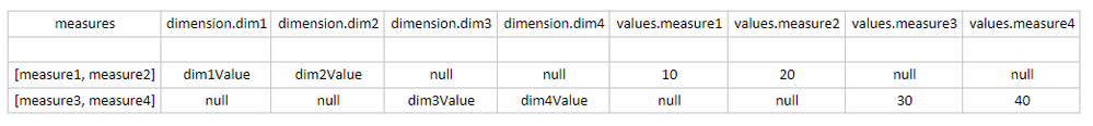

Whenever I run an aggregation query in the explore (say I try to sum measure1 over the dimension dim1), the result I get is like below.
example result
What is happening is that the SQL that runs tries to group over dim1 over all records, even where dim1 does not exist. I can get away with this by using a filter to only filter records where the measures array contains measure1. But from the end user perspective, this seems unintuitive, since the user is simply trying to aggregate measure1. Is there a way around this, i.e., not having the user specify the filter in the measure and it being done behind the scenes, like being able to ignore results if the dimension is null, or adding a filter to the measure in the LookML. Change of schema would be the last resort.
