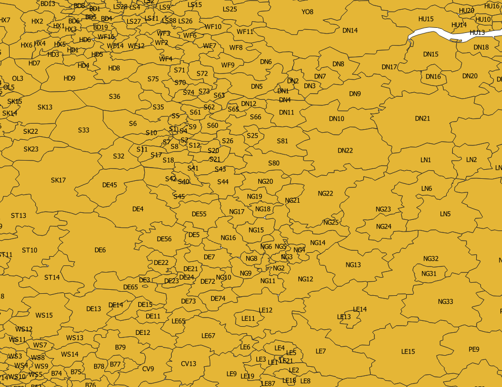

Is there any map visualisations that allow you to look more granular? such as on a district level e.g. WC1 for district, WC for area
There’s no map visualisation out of the box that supports that. You’d have to build it yourself. For example there is a district Shapefile available but you would have to convert it to TopoJSON, load it as custom map, and make sure your data is aligned with the map.
