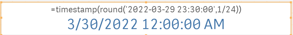

I want to the same thing, round(timestamp, step of round)
=timestamp(round('2022-03-29 23:30:00',1/24)) is equal to
