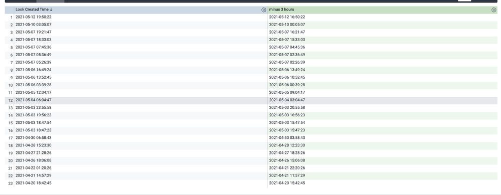

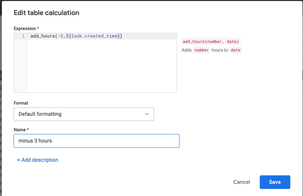

 Or we can use a table calculation similar to add_hours(-3,${look.created_time}).
Please let me know if you have any questions.
