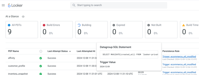

One more thing to validate is whether your SQL trigger query actually runs?
What would be the best way to validate this? Since I changed it from a sql_trigger to interval_trigger, in Admin > Datagroups, I see Trigger value: 1733678200 for one PDT (and similar for the other PDT). But when I look in Admin > PDTs > PDT Details, both PDTs have a blank trigger value, '-' (like it was before I changed the trigger).
I did notice that before I tried the manual rebuilds, it said the last attempted build for at least one of them was the 6th (Friday), when I had the successful build before, implying it didn't attempt to build in any of the 24 hour intervals since then - but then, I'm confused as to why the build showed as successful on Friday, and this morning showed as failed!
If you go to your PDT page in Admin, you should be able to click on 'persistence rule' and see the query that is being run to decide whether to trigger the table rebuild or not. Run that in SQL Runner against the correct connection and make sure it works.
