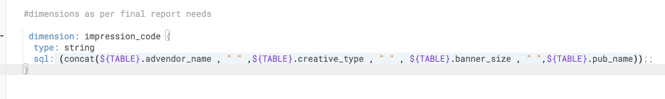

Thanks for the prompt revert, but i am still facing this error while definning a dim - impression_code

A couple years late, but for future searchers, I found that CONCAT() wouldn't accept a string as an argument in LookML Dimension SQL
CONCAT(cat,dog) worked
CONCAT(cat,' ',dog) failed
CONCAT(cat," ",dog) failed
I tested an alternate method of concatenation using + and found that cat+dog worked, and then confirmed that cat + ' ' + dog worked
