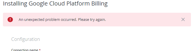

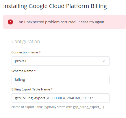

Turns out I can’t even install it:
The fields for schema and table - is it what needs to exist or what will be created?

Actually we have everything setup already the logs, audit etc. but still getting the error when trying to install the block.
The table billing which is the equivalent of gcp_billing in your example is also available through the connection because even SQL Runner sees it

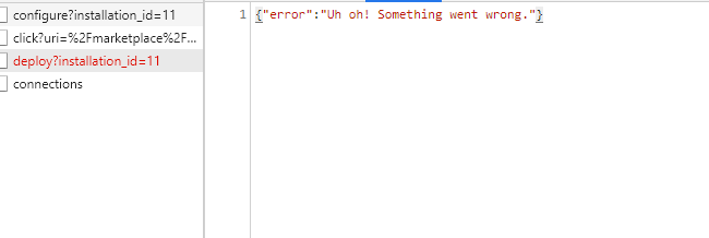

Unfortunately we’re not getting any meaningful errors here:
Hey Dawid! That does look like some funky behavior with the marketplace that we’ll want to get to the bottom of. I’d definitely recommend hopping on chat, or sending over a message via help.looker.com where we can help dig into this with you!

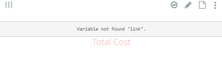

I’ve been getting this errors for a while, any chance you could help?
A LookML model issue occurred.
Variable not found "link". (In field "gcp_billing_export.total_cost")
marketplace_datatonic_gcp_billing/gcp_billing_export_core.view.lkml:245
