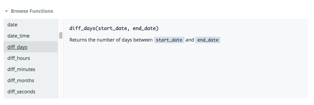

@tagga,
We do have a non modeling technique was well with our table calculations which was precisely designed to be familiar for folks who use Excel:
Hope this works for you!
