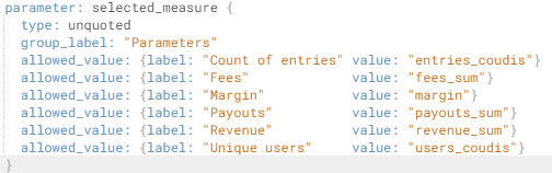

Hi Leo,
     Sorry for the delay, I just saw your response.  The liquid section is properly populating in the substitution values, it is the section before the liquid portion “Count(Distinct”,   “Sum(“,   etc. that it is wrapping in parenthesis before the liquid portion is applied, causing the liquid section to fall outside of the aggregate function.
For reference, here is the parameter though:
Thanks for your assistance, but the heart of the matter I am trying to understand is why it is trying to wrap the SQL in parenthesis, but closing that out before the liquid portion is applied, rather than wrapping the entire SQL string in parenthesis.
