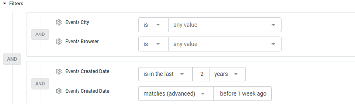

Im facing an issue in Looker that I'm not sure if its an expected behaviour or maybe a small bug: if you try to add in the filters an advanced logic (like after 90 days ago and before 2 days ago), Looker automatically creates it in a new AND filter group (see screenshot), but the issue is that when you schedule this from a Look, in the settings of the schedule that filter of date doesn't appear. Indeed I have done some testings and it seems that the schedule only shows the first level of the AND. Have you faced a similar situation? Could it be a bug? Thanks in advance🙂
In the shedule the advanced filter doesnt appear os its not applied:

It seems that it does not show those filters, but it does apply them, based on a test I just did there. But there is clearly a gap there in letting the user know what is going on. Let me see if I can follow up with the Product team on this. Thanks for bringing it to our attention!
Edit: I just checked - it seems the Product team is indeed aware of this behaviour already.
Thanks for flagging this. I notice that, when saving a Look like this to the dashboard, we get a notification as we see below, stating that 'filters using 'OR' will not be displayed on the dashboard, but I can see from the result set that they have been applied correctly. I wonder if this is a case of a missing message, rather than a bug? If you test the actual data in the scheduled Look, is it correct?
Thank you for the answer. In my case I dont see that message since Im not using an OR filter, only ANDs:
And the results in the look are correct, the generated SQL too. The issue is that when I try to shedule that Look, those filters of the second AND dont appear there, therefore I cannot shedule the Look with those filters applied, how could we solve it?
