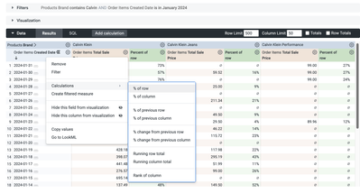

@dsimeonova , is it possible to get another graph which shows the rates of product types datewise?
Eg - In your case, 3 lines with each line indicating the percent contribution of each product, i.e first line indicates the %contribution for Kalvin Klein for given dates, second line for jeans and so on
Hey @vkhalpada !
Taking in account the same example that I gave:
Whenever you have the base query selected if you click over the Gear option of the measure, you can see the Calculations and then select % of row. Depending on how the data is structured there are some different pre-built table calculations
If none of those works for your exam I recommend you to check the full list of them here: Looker functions and operators  |  Google Cloud
Afterwards, you can decide if the absolute value is needed, if not, you can hide it from the visualization.
Hope this is what you're looking for. If not please come back here 😉
Regards!
Thank you so much @dsimeonova , it is exactly what was needed.
