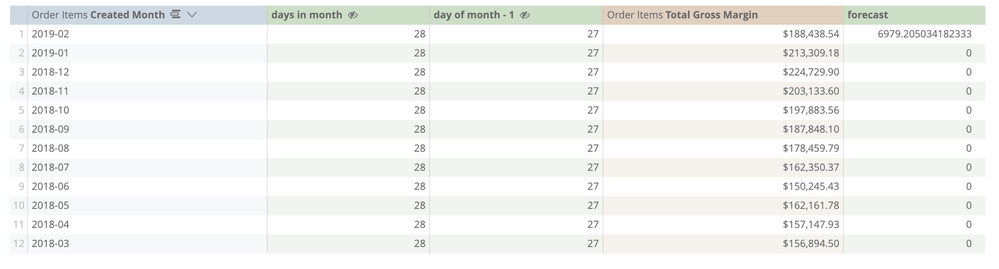

The output of this pattern will allow us to forecast the remainder of the current months performance for any KPI we are interested in (red bar indicates the forecast):

The table calcs explained below could be merged into a single calculation but in order to help understand the logic they have been separated here :
Days in Month: calculate the total days in the current month
extract_days(
            add_days( -extract_days(now()),  add_months( 1, now()) ) )
Day of Month - 1: calculate the current day of the month
extract_days(now())-1
Forecast: use the formula described above to calculate the forecast:
 if(row()=1,
     (${order_items.total_gross_margin}/${day_of_month_1})*(${days_in_month}-${day_of_month_1})
    ,0)

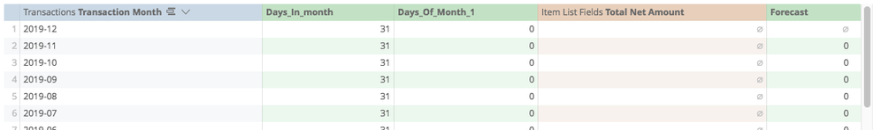

Thanks Marcus! This have been really helpful.
Manage to implement it successfully.
