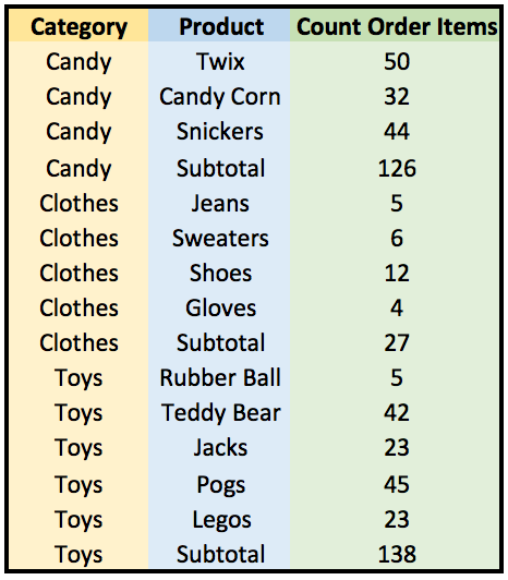

First, let’s align on the goal. Consider this example:
Patty’s shop sells 12 products in 3 categories. The total number of items ordered of each product can be calculated using a simple count from the order_items explore. This might look something like this:
Patty’s accountant has asked to also see subtotals for each category. The subtotal rows use the exact same measure as the line item rows, except they have all values from the product dimension rolled up to the value ‘Subtotal’.
To get the full story, both are included together and sorted to produce the final table:
The key here is that the underlying data shown twice, once in the regular rows and again in the subtotal rows. This can be achieved by cross joining the original data with a two row table. A cross join forces every row in the left table to join with every row in the right table. When the right table has two rows, the result is, effectively a duplicate view of the left table.

And when the above is aggregated and sorted appropriately, we get our desired subtotals:
