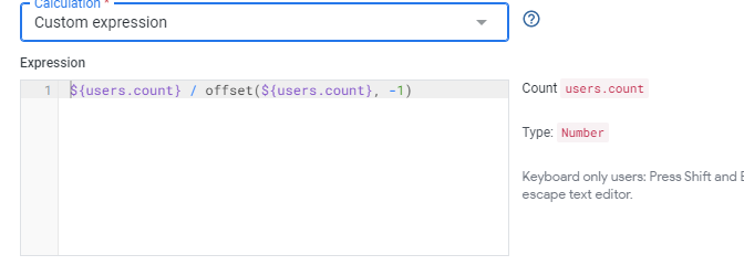

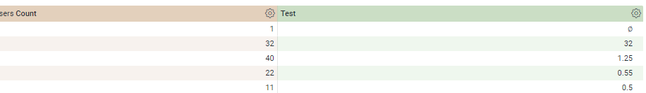

It has to be specific to your data and what you use (Custom dimensions maybe or something else). As the function itself works fine:
