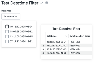

This works:
dimension: datetimes {
  type: string
  sql: ${TABLE}.datetimes ;;
  order_by_field: datetimes_sort_order
dimension: datetimes_sort_order {
  type: string
  sql: DATEDIFF(minute, '1970-01-01', CAST(${datetimes} AS DATETIME))  * -1 ;;

Can you send me a screenshot like the one I made? Show me both the filter and the two dimensions in a tile:
