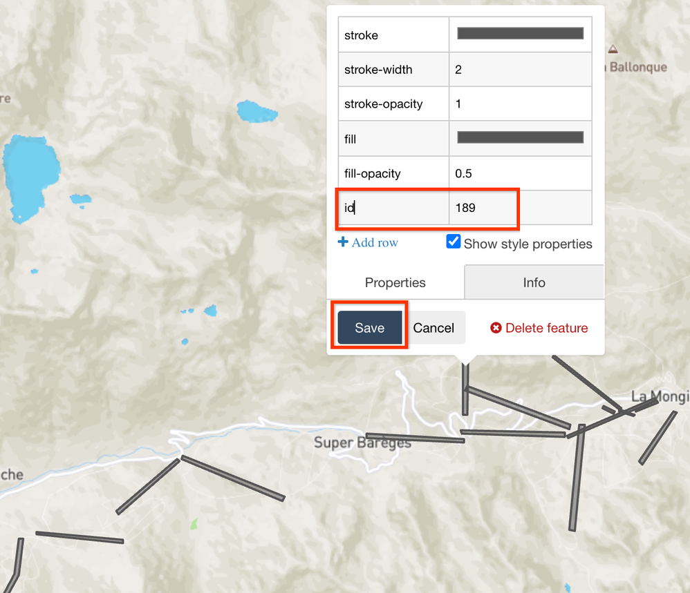

  2. then the important step is to attach a unique code to each shape so that you can link each shape to a value in Looker’s dimensions. For this, just click on your shape and then add the name of dimension you will be using and then the value that is the one you would get in your database:
    if I click on another shape, I will also put “id” but with a different value:

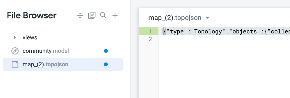

  1. next, you upload the file in Looker:
  1. you define the map_layer in your model file and tell looker the name of the field where you stored the shape value in your topojson, in our case is is “id”

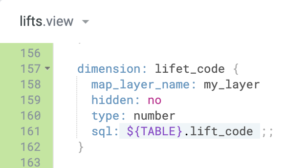

    1. then in my view file wheere I store the lifts id, I just need to tell looker this is where I have a dimension where I store the id to match each shape with a value in each shape:
