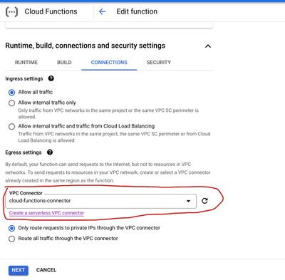

1) Please verify Serverless VPC Access is enabled and configured properly. This is required for Cloud Functions to properly connect to Cloud SQL via Private IP. Please refer to this documentation for the exact steps but to summarize, "For private IP paths, your application will connect directly to your instance through Serverless VPC Access".
Key takeaways:
  • Verify that a Serverless VPC Access Connector was successfully created at: https://console.cloud.google.com/networking/connectors
  • When creating a Cloud Function, the Serverless VPC connector must be visible and selected in the "Runtime, build, connections and security settings" > "Connections" section under "VPC Connector".
