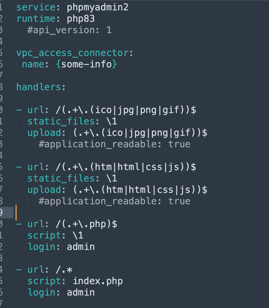

App engine use phpmyadmin 5.1 and php 8.2 get mine_type error
I use app engine to deploy phpmyadmin 5.1 , when I use phpmyadmin web i got some error
message.php was refused because mine_type error
app yaml
Has anyone else encountered this problem and solved it?

Hi @robertcarlos ,
In fact I use php 8.2,the screenshot was test do it but I use version 8.2 still get the same error.
I do some other try found some information, I comment out js and css route in the app.yaml get the same mine_type error, so i guess cause this problem it was message.php not route to correct, but I try many route rule, still not fix it.
Same problem, I get a blank screen with 45 MIME type errors
