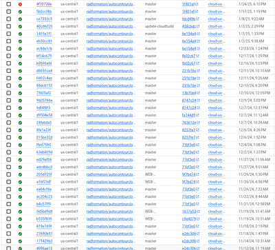

Whereas I might get a 502 once every 20 uploads from my local PC, nearly >50% of all uploads from a Cloud Build environment fail with 502. That's how we pinpointed that something changed between Jan 17th and Jan 24th 2025 - because that's when the very first 502 started happening for us:
After that it's just been non-stop 502 failures. We've tried retry/backoff and lots of other things with limited success.
