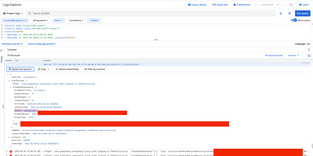

Hi all,
I’m building a serverless application using Google Cloud Run, where several Cloud Run services (functions) need to interact with each other. I’m using Cloud Tasks to queue and trigger these services in a controlled sequence, and also to track success/failure at each sub-stage.
It works well about 50–60% of the time, but for the remaining executions, I’m seeing “unavailable”errors in the logs. I’m struggling to figure out what’s causing this — there are no obvious patterns in timing, payload size, or concurrency that I can see.
Has anyone experienced something similar or have thoughts on what could cause intermittent unavailability of Cloud Run services triggered by Cloud Tasks?
Appreciate any and all leads  🙂
Thanks! Target Cloud Function is UnavailableTarget Cloud Function is Unavailable

Thank you so much for your reply @Joy_S . Unfortunately, it's none of these. The error I get is "NOT FOUND" as you can see here.
