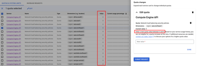

I have same problem with Cloud Armor. I cannot change quota limit for Security Policies, all quotas is zero.
I also added billing account and even prepaid 50$ for billing account.
