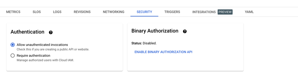

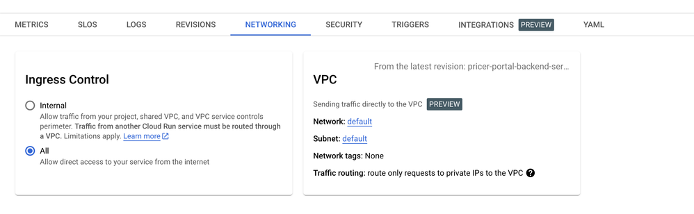

@NoCommandLine When I make both the services public everything works. It is only when the backend REST API service is made private that I face the issue. What should be the security setting for a private service is it `require authentication`?. Below are the networking and security   settings for the backend CR service. As you can see it is public and accepting unauthenticated calls.
Screenshot 2023-11-19 at 11.32.53 AM.pngScreenshot 2023-11-19 at 11.32.46 AM.png
Yes, it should be 'require authentication'.
So there's confirmation the issue is with when you set it to private.
Can you provide a snippet of your code where you obtain the token and then make a call with the token (here or in a GitHub repo)?
