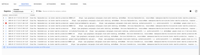

We have the following problem, we have 2 projects
prj-cross and smk, in the prj-cross project the containers write to the log without problems, but in smk they don't log anything, only the gcp log. In both projects the service accounts have the same permissions, but we can't understand why in the smk project it doesn't write to the log.
