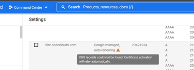

DNS records could not be found. Certificate activation will retry automatically.
Hi
Our website is down and it is showing certificate is expired. When I check the custom domain settings section in GCP, I am getting the following warning.
We have removed the records and re-added them, but showing the same warning.

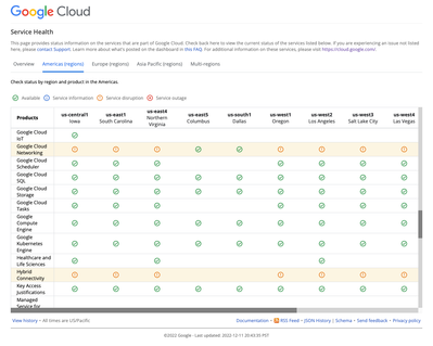

We found from google cloud status that some of the products were down last day.
These statuses are okay now and our website is also up and running. So this must be the reason our website was down.
