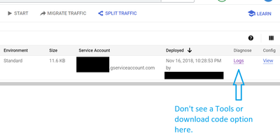

4. From the same SO answer, it suggested going to Versions > Diagnose > Tools and then downloading the source code, but I don't see that on my GAE page.
That feature has been deprecated by Google (see annoucement)
