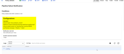

    Also I setup a log based alert with below configuration:
    and I intentionally failed a pipeline to check the alert:
    But still there is no incident shown in the alert monitor tab and no mail is generated:
    Can you help us a bit in resolving this issue as well.
