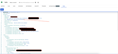

Are you referring to the uid marked in the snapshot attached related to service with two containers.
If yes,  this identifier appears to be for service as a whole.
For a multi-container service, is it feasible  get the container Id(uid) for the individual containers
Or am I not accessing the correct tab ?
so if you're doing multiple containers - go to the revision tab --> select yaml and goto the spec of the container and the uid should be the container id

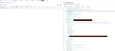

Hi @djs_75 , not sure if I'm missing something, I am unable to see the container Id in the spec.
Attaching the snapshot of a Revision->yaml of a service with two containers.
Cloud Run does not expose container id as a part of service or revision yaml. Could you describe the use case for fetching the container id?
