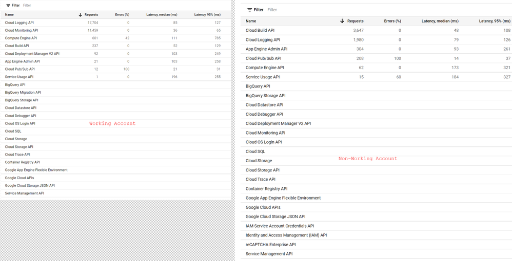

Here are my roles assigned to my service accounts on both my working google cloud account, and the non-working one.
Here is a comparison between my enabled APIs on both accounts:
I set both of these cloud accounts up and I do not recall doing anything differently for the one that is working than I did for the one that is not.

everything on my working account works fine for the application in question.  A few things I've done since making my post:
1) verified billing is ok on non-working account
2) tried deploying in incognito
3) tried deploying using the google cloud sdk console
4) made both account APIs identical
5) made service accounts and permissions identical on both accounts
6) checked location matches on both accounts (central-us)
