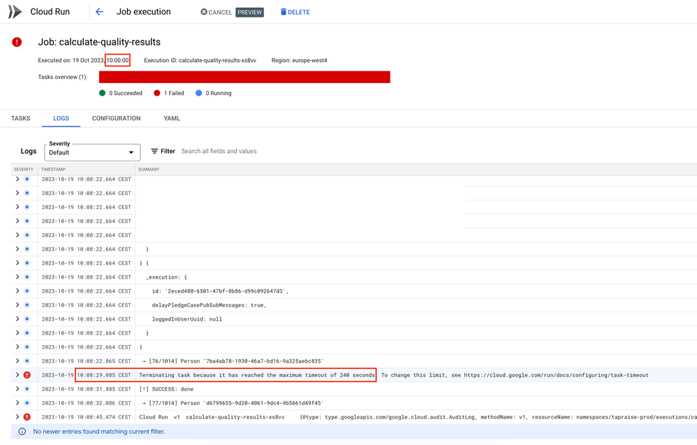

Hi Aaron,
I have set a task timeout for 4 minutes, but it usually takes between 8-12 minutes before the timeout actually triggers. Is this a known issue or something to be fixed from my end?
Scherm­afbeelding 2023-10-19 om 10.15.58.pngScherm­afbeelding 2023-10-19 om 10.18.56.pngScherm­afbeelding 2023-10-19 om 10.15.39.png
Kind regards,
Robin van Wijngaarden
Hi Robin, I took a look at the job execution in your screenshot and the reason it's running for 8-9 minutes is because your job is configured to allow 1 retry. The first attempt runs and times out after 4 minutes, then a second (retry) attempt runs and also times out after 4 minutes. You can see this in your screenshot in the left-side panel where it says "Retries: 1" and in the right-side panel where it says "Number of retries....1"
You can set this field to 0 to disable retries. See https://cloud.google.com/run/docs/configuring/max-retries for more information on how to view and configure this setting.
Ah, damn. My bad. Thanks for pointing that out!
