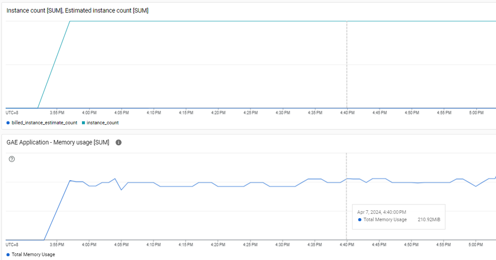

I did also check the memory usage but there does not seem to be an issue. I am using a B2 instance class which should have 768 MB of RAM and during the time period of the incident RAM usage was low at roughly ~210 MB.

  • I have tried to increase the instance size to B4 (1536 MB RAM) thinking that maybe the Memory Usage is not being reported correctly, but the same problem occurs.
