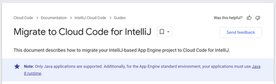

https://cloud.google.com/code/docs/intellij/migrate
"... for the App Engine standard environment, your applications must use Java 8 runtime. "

Now I discover that the latest Cloud Code plugin only supports Java8 which Google are phasing out. Whereas the previous version of whatever plugin I was using was happily deploying my Java17 app.

After another update to the plugin was applied, the deploy to cloud process mysteriously started working again, and appears to have published my App Engine Standard app to a Java17 runtime even though the documentation I am citing above appears to be saying that this is not possible or not supported or something?
Seems like there is lots of confusion being generated by a combination of misleading documentation and messages within the UI of the plugin.
