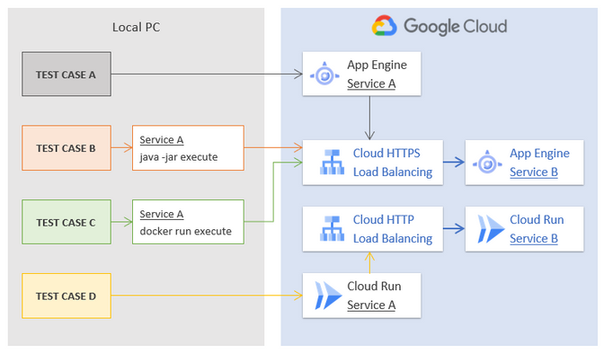

To check why the log is occurring, the test was performed by configuring the environment below:younghunyun_0-1675131852008.png
Service A is the same source code, but the environment running was tested differently. As a result of several tests, the 'Connection reset by peer' log occurred 610 or 620 seconds after the last LB domain call only in TEST CASE A.

Thanks for your answer.
As you explained, I understand that the cause of the log is reset the client's connection due to the 600 seconds timeout setting of HTTPS LB. That's why I performed test cases to verify it.
If the cause is the timeout of HTTPS LB clearly, the same log should have occurred in my test cases B, C, and D, but it only occurred in A. Test cases A, B, C, and D differ only in environments that run JAR files that build the same source. The source code is a simple code without using provider. That's why I want to know if there's a difference between running with java/docker in the local PC environment and deploying it to App Engine.
- Test Case A : Deployed service in App Engine → HTTPS LB
- Test Case B : "java -jar APP.jar" in Local PC→ HTTPS LB
- Test Case C : "docker run BUILD_IMAGE_FROM_JAR" in Local PC→ HTTPS LB
- Test Case D : Deployed service in Cloud Run → HTTPS LB
- Test results are below:
Time delay after previous LB callABCD
0 sec200 OK200 OK200 OK200 OK
60 sec200 OK200 OK200 OK200 OK
300 sec200 OK200 OK200 OK200 OK
600 sec200 OK200 OK200 OK200 OK
610/620 sec500 Error200 OK200 OK200 OK
1200 sec-200 OK200 OK200 OK
6000 sec-200 OK200 OK200 OK
If I can find the reference for a connection setting in an App Engine environment that is different from the local environment, the cause analysis would be clear, but I could not find it. Is there anything I can check more about the App Engine environment?

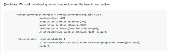

In my case, the 'Connection reset by peer' issue was related timeout settings of client and gcp resources.
In the condition with Reactor Netty version: 1.0.10 and Spring boot version: 2.5.4, the existing channel is disconnected and a new channel is created when a request occurs after 10 minutes of idle time. The service was modified by adjusting the setting value for connection.younghunyun_0-1708724710187.png
Note that the HTTP LB timeout and keepalive timeout values for GCP cannot be changed to 10 minutes.younghunyun_1-1708724854425.png
And when the connection is terminated in LB, the connection of the client is also terminated, and an error occurs when a new request occurs at that time, so we set the maximum interval setting less than 10 minutes, which is LB's idle timeout
Depending on the client configuration or environmental conditions, this may not be the right answer. You need to configure a testable environment and change the settings to different conditions.
