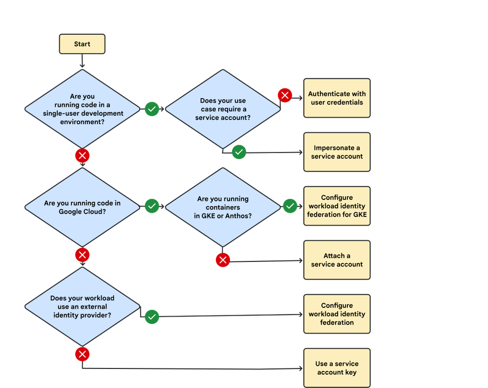

I managed to solve it. Anything which would require OAuth won't work because Cloud Functions is on the back-end side and OAuth at some point would try to popup a browser for authentication.
You need to setup a service account, see https://cloud.google.com/docs/authentication#auth-decision-tree and https://cloud.google.com/docs/authentication/application-default-credentials

Anything which would require some type of OAuth mechanics would fail because Cloud Functions is on the back-end and the system would want to popup a browser to ask for credentials and complete the OAuth auth flow.
This is even true when you are experimenting with iPython notebooks with code what you want to use in the Cloud Function: it gonna open a browser (for example at the `vertexai.init` step, see https://github.com/CsabaConsulting/NextGenAI/blob/main/ImagenTest.ipynb).
So you need to establish a service account and go through some configuration. See also https://cloud.google.com/docs/authentication#auth-decision-tree and https://cloud.google.com/docs/authentication/application-default-credentials
