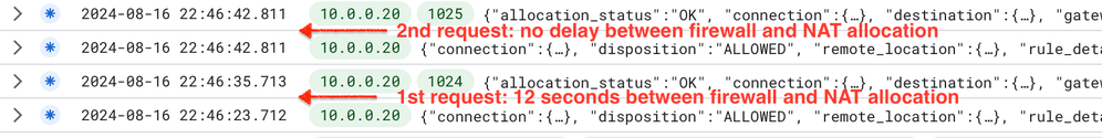

Edit: nice illustration of what I'm seeing -- a 12 second delay between the firewall seeing the egress request and the NAT allocation.

Here is a picture that illustrates what I'm talking about: I've made a "egress-allow-all" firewall rule that just logs everything, and you can clearly see the 12 second delay between the firewall seeing the request and the NAT allocation -- even though the nat routing (as seen in one of the replies above) is already there for this source ip/port
