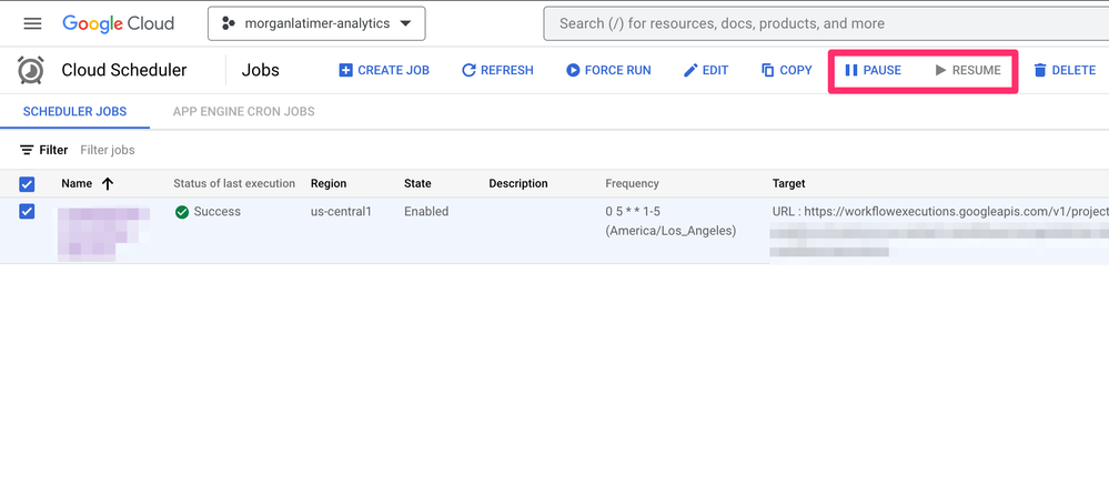

Ran into this problem as well scheduling a workflow. Updated the service account with the Workflow Invoker role didn't fix the problem immediately. Then I paused/resumed the scheduler job and the problem went away.
