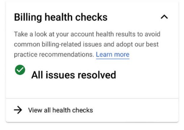

I checked payment account first, no problems was found

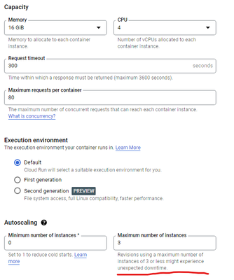

based on the screenshot where you tried to decrease the instances to 7, it is saying your memory is too low. Have you tried either reducing the number of instances to 3 as suggested or increasing the memory allocated?
I have tried this config
And it's work, but I think it is not good to set max 3 instances

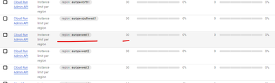

There is quota for my project
I have only one Cloud Run service in europe-west1 region, but i can deploy new revision with only Maximum number of instances: 3
I don't understand what quota i should increase
Region quota.
