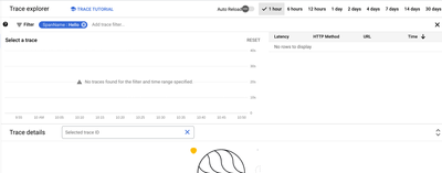

This runs without error, but from the Cloud Console, the trace does not appear:
