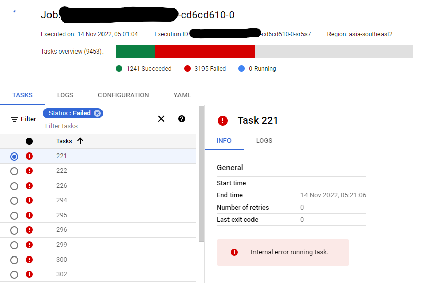

However, since last weekend, we have observed a significant number of failed tasks with the message "Internal error running task". It also seemed that those tasks haven't started, since there is no "Start time" and we found zero logs for the particular tasks.
Here is an example of such a job. All failed tasks here show only "Internal error running task" and nothing else.
Note that the above job is still running at the time of writing. It's been running for over 7 hours. In this particular job, a successful task typically completes in under one minute. We set the timeout to 10 minutes and parallelism to 50.
Also, we noticed that this happened on jobs with a larger number of tasks (> 8k). Our jobs with fewer tasks have finished successfully, even though they ran noticeably slower compared to previous weeks.

we have exactly the same problem here.
Our two Cloud Run Jobs don't work anymore since last friday.
If you execute them, they go in status pending, after ten minutes they fail with errors but no log files.
The job execution YAML file shows the following message (under status): "Failed to start execution deployment. Deadline exceeded."
Both jobs have a serverless VPC connector attached which worked fine until last week.
