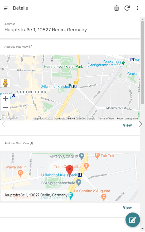

Address or XY as a Map in Detail View

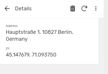

Usually an Address or a XY value shows up as Text in Detail View.
But what if you want to see also the map in Detail View?
This App shows how to do it.
You have to create a Parent-Child relationship and use the map inline view.
Usually you would use a read-only Slice. But you donโ€™t have to. Just use this expression in a virtual column:
REF_ROWS("Your_Table","Key_Column")
The Address column would look like this:
The XY coulmn would look like this:
The App shows different methods: With and without Slice, Map view or Card view, Address or XY.
Iโ€™ve added also the ability to change the XY Background Image.
Here is the Sample App:
