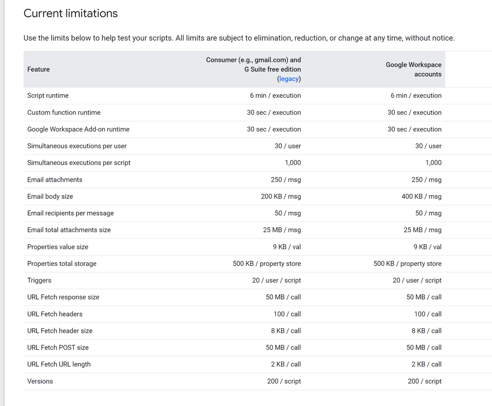

Google Apps Scripts has a limitation of 30 "simultaneous executions per user" - meaning per accountSo you can only have 30 things running at any one point for your account,  you can have more if they're using a different account (running the same script) - but we're practically limited to 30 executions at one time.
  • So this means that if I'm scheduling a bunch of scripts to run every 5 minutes, then I need to keep this number under that - and I should leave some head-way for other scripts to run on my account as well.
    • 20 seemed like a good number (^_^)
