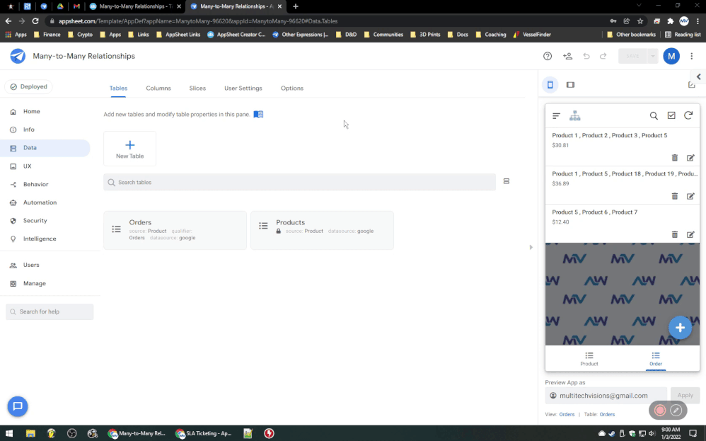

But there is another relationship connection type that allows you to connect many records to many records
  • Let's say you have a table of records (say Products) where each record can be related to many records in another table (say orders).
    • This means when you look at a product, you can see a bunch of related orders - and when you look at an order, you will see a bunch of related products.
AppSheet doesnโ€™t support this type of relationship by default, though it is possible to implement this functionality
  • It just takes a little setup is all (^_^)

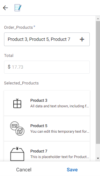

Quick question/observation: this currently only allows adding new orders but doesnโ€™t allow adding new products since the Products table is set to read-only. My app has a requirement to support adding new Products and then to associate the product with one or more Projects (similar to your Orders table). Similarly, by creating/adding new Projects, I need to associate one or more Products to one or more Projects. With this requirement, I believe this would still require creating an intermediary table that connects the Products and Projects tables together - storing Product IDs and Project IDs in the table.
This would be a good thing to store in itโ€™s own table, yes.
So Iโ€™m a little stuck right now trying to figure out how to accomplish what Iโ€™m trying to do. Hereโ€™s my needs:
  1. I need to be able to pick/select multiple Projects for a single Product. From the Products edit screen, how can I include an Enumlist to provide all active Projects, and then based on which ones are checked, store those in the intermediary table that connects the Products and Projects (letโ€™s call it Project Details)? Iโ€™ve tried adding a โ€œProjectsโ€ column to the Products table as an Enumlist with a base type of Text, and the Valid If = SORTED(Projects[Project Name]). This gives me the list of all projects in the Projects table to pick from, and when saved, it does save the project names in this field. However Iโ€™m not clear how to show all of these selected Projects when viewing from the Projects table to display a single project and which selected products.
  2. From the Projects table, when viewing/editing a project, I need to be able to A) view which products are associated with this project, and B) to edit/update the selected products to check or uncheck products.
So basically I need to be able to add/edit bi-directionally - either when viewing/editing products to pick which projects itโ€™s tied to, or when viewing/editing a project to pick which products are associated to it.

Thanks for replying, but in the app Itโ€™s does not have quantity, for example, If I choose product 1 with 3 item, and product 2 with 4 items ?
@Phong_Lam you canโ€™t do that with this method
  • If you think about it: where would these totals for each product be stored?
  • Youโ€™re simply selecting a bunch of products from a listโ€ฆ whereโ€™s the place to store the values for these?
You need a separate place to store the data pair (product + qty)
  • and that means you need a separate table, one record for each selected product.
