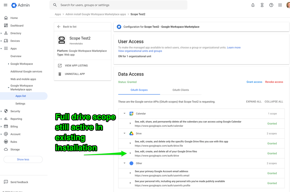

  1. Adding a scope to your App Configuration causes existing installations to go into a “Partially granted” state, as shown here when I added a calendar scope. Apps can’t use the new scope until Admins grant access to the newly added scope.Screen Shot 2024-04-22 at 2.06.36 PM.png
  2. Removing a scope has NO IMPACT on existing installations, as shown here when I removed the full drive scope on the test app configuration. In fact, the full drive permission stays active for existing installations and can continue to be used. Only new installations are affected - they will not request access to the removed scope.
    Workspace Admin Console...
  3. That means the scope removed from the App Configuration will only be removed from existing installations if Admins uninstall the app entirely and reinstall it.
This is all very good news for our situation. This means we can safely remove the full drive scope from our App Configuration so new installs don’t have to grant this permission, while existing installs will continue to work seamlessly, without us having to message Admins to re-grant access to our app.

In my experience, when a new scope is added to an app that is already listed, the Data Access section for the app goes into a "Partially Granted" status as shown in Item 1 of my original post. The new scope cannot be used with the domain until the Admin manually grants access to the new scope.  Trying to make an API call when the scope has not been granted access yet will result in a 403.  Unfortunately the Admin is not notified by Google Workspace that there is a new scope waiting for access to be granted.  So when a new scope is added, it's up the to app developer to communicate with customers/admins about the new scope and recommending they manually grant access.
