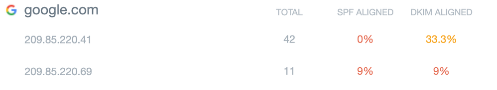

That's how I understood it.. but I've been monitoring DMARC for this domain, and despite having the correct DKIM signature (see my original post) DMARC is failing.
Here is the relevant part of the report:
I've spoken to multiple people at Google who acknowledge the issue, but have no idea how to escalate it to someone who can do something about it.

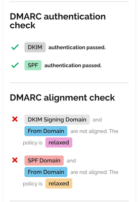

Are you sure that's correct? SPF and DKIM pass for both domains, but DMARC fails (even in relaxed mode).
If I inspect the email being sent, it still contains information related to the primary domain (the SPF and DKIM being checked are from primary domain). And it's this mismatch that gets flagged (results below from https://redsift.com/tools/investigate)
Yes, absolutely positive. I use secondary domains every day. SPF does not align, but DKIM does, and so DMARC checks out, when set with a relaxed policy.
I don't know how RedSift works and how to interpret their results, but if it is telling you that DMARC failed, then something is wrong in your SPKF/DKIM setup or DMARC policy somewhere.
Here is what it looks like for me (I am using Dmarcian):
Note I have redacted the domain names. In the From: domain, it would show my alias domain, but in the SPF section, the from: would be my primary domain. This is why SPF does not align. However, since the correct DKIM signature is passed along, DMARC still authenticates the email.
This is how DMARC is designed. It is accounting for forwarded emails, which typically break SPF. If your DMARC policy isn't set to strict (which it never should be), then DMARC will pass, as long as the from domain (your secondary) and the DKIM signature match.
Looking at your screenshot again, I think you're fine. Your DMARC authentication PASSED. Only alignment failed. This aligns with what I explained above. You should not have any delivery issues, unless your DMARC policy is set to strict.
