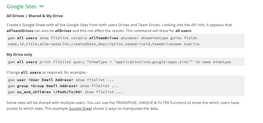

I have used GAM ADV for this type of search.
I found the command in this website.
Hope this helps you out.
