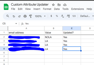

@vrnazre That is great. I set it up and tested it and it was so simple to do!
I'd like to automate it. Do you think this would work?
  1. Set up the Google Sheet with all users with the "Updated?" column initially set to "YES" (assuming that all users have the custom attribute set already)
  2. In the Apps Script, enable either:
    • a 'Time Trigger' to run every hour or
    • a 'From Spreadsheet' trigger based 'On Edit'
  3. Then when I want to update a users attribute, I can just set the new attribute and clear the "YES" value from the "Updated?" column
The thing is I had added the "Yes" status to make sure the completed ones don't get updated again. As there is some quota tied to the API. Yes, definitely you can automate it based on your requirements. You can further make this code better by simply retriving the schema category and field from the sheet itself(like a sheet context based browser input box or from a some fixed cell in the sheet)
