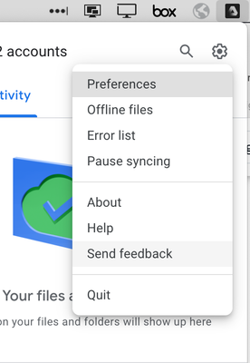

Sounds like it may be a sort of a bug. I'd report it via the "send feedback" link in the Google Drive app:
You won't get a response, but the product team will see it.

Hopefully, it is just a bug, I have sent the feedback through the app like in the screenshot you sent! Thankfully it isn't a complete blocker, but it's a shame and I hope they can add this improvement.
