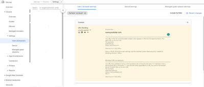

@jemarra  Have you tried blocking the youtube URLs:
https://www.youtube.com/  and anything else you know
I have blocked the url but the problem continues.
