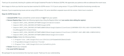

From Google Workspace support, not the best solution since it will likely involve having to visit every machine to roll them back, but at least they are admitting a known problem and are working on it:
Please be informed that it is a technical issue having errors, issues, unusual behavior about the new version of GCPW (122.0.6260.0), please note that the new version was rolled back due to an issue that was seen. When they download GCPW thru the Admin Console page, they should be getting the previous version: 94.0.4606.56
We do apologize for the inconvenience and allow some time for us to release a new stable version of GCPW soon and to set your expectation that there is  "No ETA" yet. In case that you are still getting (122.0.6260.0) version from the Admin Console, we highly suggest you to try downloading GCPW thru https://tools.google.com/dlpage/gcpw/
Here are some instructions/HC articles that may help you with your concern.
1. Uninstall Google Credential Provider for Windows: https://support.google.com/a/answer/9698385
You can also try to uninstall GCPW by following the instructions below.
1. Uninstall GCPW
2. Remove the following Windows registry keys
 - Computer\HKEY_LOCAL_MACHINE\SOFTWARE\Google\Chrome\Enrollment
 - Computer\HKEY_LOCAL_MACHINE\SOFTWARE\Google\GCPW
 - Computer\HKEY_LOCAL_MACHINE\SOFTWARE\WOW6432Node\Google\Update\ClientState\{430FD4D0-B729-4F61-AA34-91526481799D}\CloudManagementEnrollmentToken
 - Computer\HKEY_LOCAL_MACHINE\SOFTWARE\WOW6432Node\Google\Update\ClientState\{32987697-A14E-4B89-84D6-630D5431E831}
 - Computer\HKEY_LOCAL_MACHINE\SOFTWARE\WOW6432Node\Google\Enrollment
3. Remove the following folders
 - C:\Program Files (x86)\Google\Policies\Z29vZ2xlL21hY2hpbmUtbGV2ZWwtb21haGE=
4. Restart the machine (and re-install GCPW if needed)
Try to fix the issue by uninstalling and installing the Google Credential Provider for Windows
