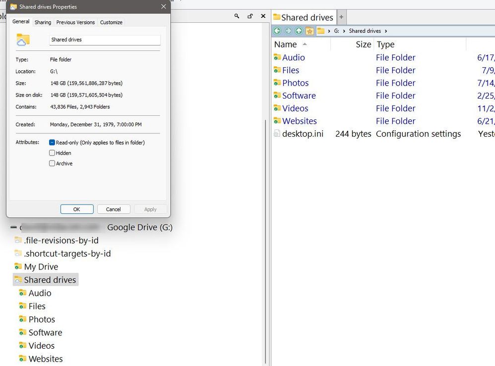

Follow-Up - and here is another screenshot comparison. If I look at the size of the team drives that I sync offline, they read as 148 GB. However as noted above, the  GFS cache folder is only 109 GB. How can there be such a discrepancy? And I believe the GFS cache also holds "My Drive"? In which case I'd think it would be holding way more than 148 GB.

And about having more data online than you have locally (now I'm addressing the screenshot from your follow-up) this can also be due to several reasons, but if I had to guess I'd say that you probably have one or more hidden shared drives, or that the file explorer is getting the information about the size from the local cache instead of directly from the cloud. To test this you can use another computer (that is not currently using the Drive sync client) and log in to another account with access to the same shared drives and keep everything online only and then right-click and check the details. If you don't have another account log in with yours, but keep everything online only.
It could also be related to not having synced everything "down" yet. The sync client can run in batches and show that everything has been synced and then start again, and again, and again...
Or it could even be related to having multiple versions added to the same file (Google Drive allows you to store more that on revision of a file) but this information shouldn't reach the sync client so the local file explorer shouldn't have that information...
