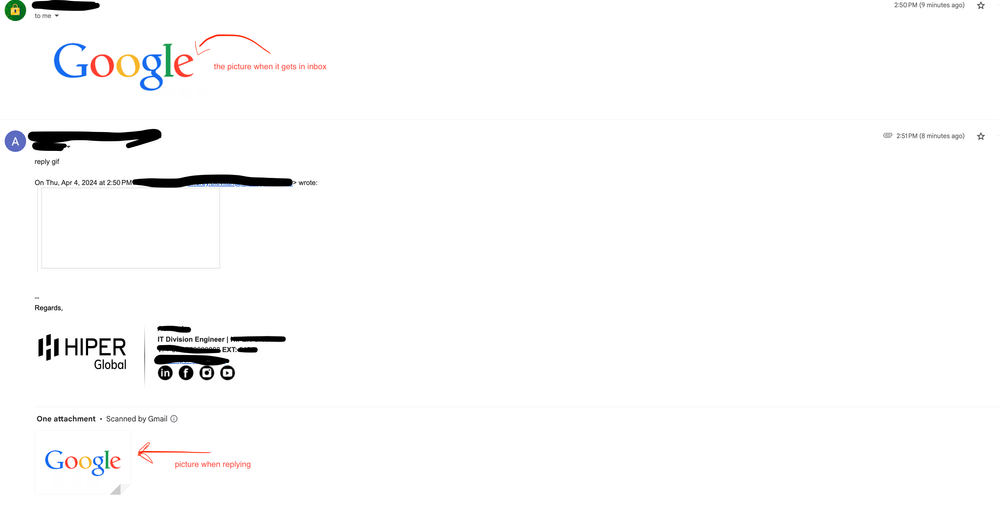

i've been talking back and forth with google support to try and resolve the problem unfortunately they did not game me any solution and put the blame all on outlook.
i'm sure its not a problem with outlook because the problem happen only when replying via gmail.
pleas help i'm lost here and its very frustrating and as for now one on the internet could help me with this problem google included .Screenshot 2024-04-04 at 15.00.49.png
